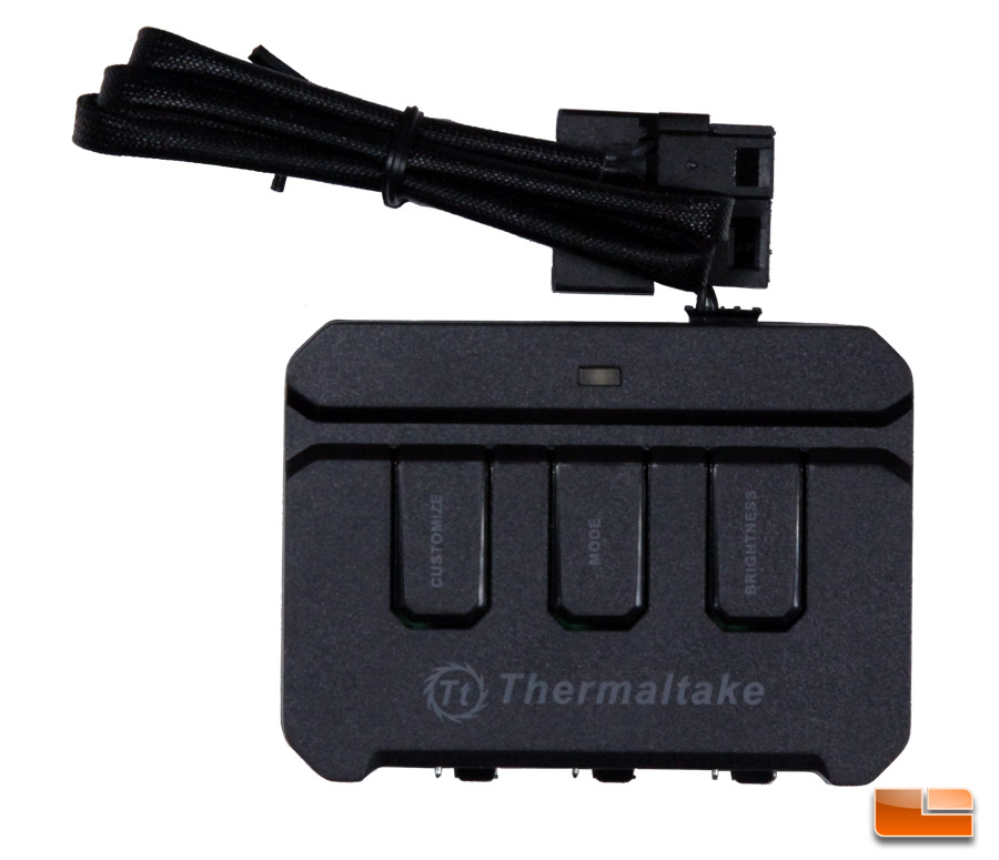

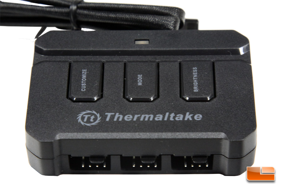

Thermaltake Lumi Color 256C The control module is a compact box measuring 3.1 x 2.3 x 0.8 inches / 80 x 60 x 20mm that powers the LED strips and has three buttons for changing the light color. We will run down the functions of the buttons from right to left.
Brightness toggles brightness levels and pressing the button for three seconds powers the module on or off. Pressing Mode quickly toggles between seven steady colors white, red, yellow, green, cyan, blue, and purple and pressing Mode for three seconds triggers a flash effect that turns the lights on and off while cycling through those seven colors. Pressing Customize triggers a rolling RGB effect where the lights for the most part transition smoothly through 256 colors and pressing this button again will pause and remain steady on the current color until Customize is pressed again.
Thermaltake Lumi Color 256C Up to three RGB LED strips can be directly connected to the control module.
Thermaltake Lumi Color 256C The control module connects to the computer power supply with a Molex connector.
