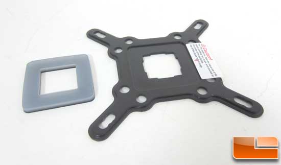

Prolimatech Genesis CPU Cooler backing plate
Speaking of the backing plate. The Intel LGA775/1155/1136/1366 backing plate is steel and comes with a silicon spacer for LGA775 socket.
