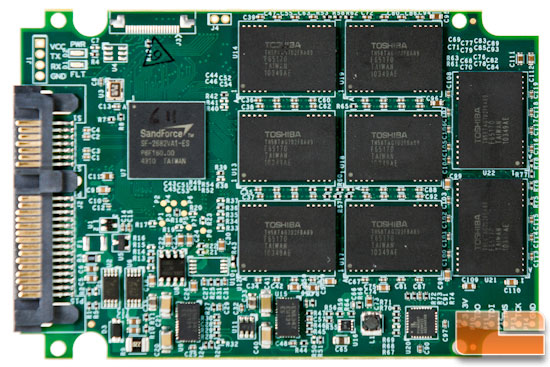

Vertex 3 Pro PCB
On the other side of the PCB lies the jewel of the drive. The SandForce SF-2582 controller is basically the next generation SF-1500 controller, carrying the same great features as its predecessor with the DuraClass technology. It employs compression to boost performance and stores data in a highly secure AES-256/128 hardware encrypted format. Best of all, it’s SATA III (6Gbps) compliant which means no more bottleneck due to the interface.
Vertex 3 Pro controller
If you look at the picture above you’ll notice that the SandForce controller is labeled SF-2682VA1-ES. At first we that this was a SF-2682 controller, but was told this by OCZ:
“These are early silicon and they only built 2682 for the first batch. 2582 firmware is running on it, so for all intents and purposes this is running as a 2582 and thats what we will ship in the Vertex3 Pro product. Im not sure how you want to convey this throughout the article.” – OCZ PR
