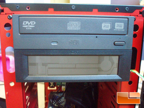

Since I have many computers, the hard part was deciding which case I was going to install the fan controller in. I wanted to install the Sentry 2 in a case which would use as many of the five possible connections, so I decided to use my Helios 910R which has four fans, two intake and two exhaust. Installation of the Sentry 2 is relatively simple. After pulling the front cover off the front of my case, I simply slid the fan controller into an available 5.25 drive bay slot and locked it down with some screws.
