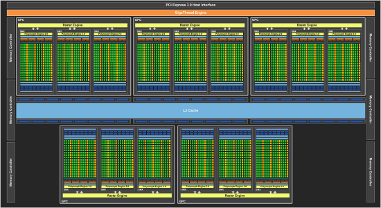

NVIDIA GK110 Block Diagram
The GK110 features 14 SMX units with 192 CUDA cores per unit, which adds up to 2688 CUDA cores. It has six memory controllers, 1.5MB of L2 cache and is linked to 6GB of GDDR4 memory running on the 384-bit memory bus. If you are counting SMX units in the image above, you will count 15. The reason for this is that one of the SMX units is disabled as each NVIDIA GK110 GPU is built with 15 SMX units and 2880 CUDA cores in total. The image above shows 15 SMX’s, but one is deactivated. We asked NVIDIA if they would come out with a lower cost, GK110 powered desktop gaming graphics card with maybe another SMX unit disabled, but they declined to comment.
