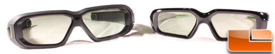

NVIDIAs 3D Vision 2 offers several improvements from the previous generations offering. During use the most noticeable change is the added brightness, not only due to 3D LightBoost on the monitor. It appears that unlike in the previous generation where the lenses would go 100% black, the new generations glasses will never fully darken and stay open longer. This means that visually it appears brighter, which is especially helpful if you game in a lit room and makes it easier to see things besides the monitor (keyboard, food/drink, etc) while in 3D mode. The additional size of the glasses also helps as they block more of your peripheral vision than the previous design which as an end result is less distracting.
Overall the new glasses are a bit more comfortable than the old, with the new design helping quite a bit when wearing large headphones or headset. That being said, the new design has not solved the problem 100% which seems to be due to the roundness that the earpieces have. The earpieces start to curve away from your head a bit too early which headphones end up slightly resting on. They are far more comfortable to wear than the old design, but there is still some room for improvement.

For those with a previous generation 3D Vision setup, the new glasses are a definite upgrade. The increased lens size giving increased brightness due to letting more light in is worth the $99. Many gamers with an existing 3D Vision setup will also probably be running into the issue soon where the batteries in their glasses are no longer holding a good charge, making for an excellent excuse to upgrade to the new glasses as well.
