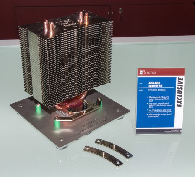

Last but not least, Noctua showed a prototype of its mounting upgrade kit for the upcoming AMD AM4 socket. The upgrade kit will be backwards compatible with all Noctua retail coolers since 2005 except the NH-L9i and will offer the possibility of installing the cooler turned by 90. Owners of Noctua coolers will be able to order the kit free of charge by uploading a proof of purchase (scan or electronic copy of the invoice) of both a Noctua CPU cooler and an AM4 CPU or motherboard. The kit will be available as soon as the AM4 platform is officially launched.
