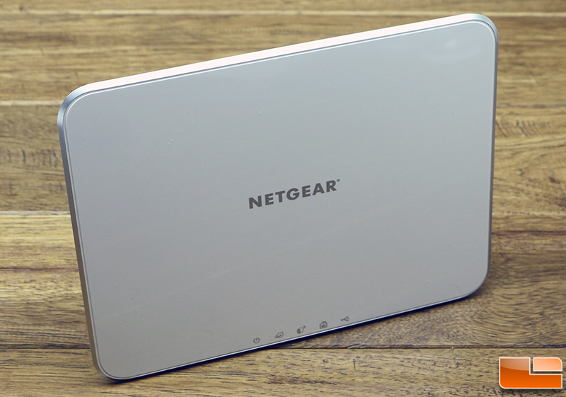

The security system requires the use of an 802.11n base station that has been optimized to use as little power as necessary for the WiFi cameras as Netgear wants the batteries to last as long as possible. How secure is your video feed that is going to the cloud? Netgear told Legit Reviews that all video is sent to the cloud using the https (Hypertext Transfer Protocol Secure) protocol, which is the same as your credit card or banking info. The netgear hub has a pair of USB 2.0 ports on it that aren’t used with the Arlo system, but are there for future devices. Netgear told Legit Reviews that the USB ports will be used in the future to add USB adapters that support other smart home standards. This will allow the Arlo platform to support other smart home devices including lights, sensors and more. So, hopefully you’ll be able to connect other smart home devices like Zigbee and Z-Wave antennas to the two USB ports located on the back. Netgear is also part of the AllSeen Alliance open source project, a group of companies working on interoperability between Internet of Things (IoT) devices.
