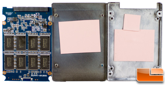

After performing the usual void sticker-ectomy, we were inside the drive in no time with the removal four screws.
Kingston V300 120GB Opened
Due to the thermal pads, the the PCB is stuck pretty well but peels off with careful pressure. Kingston is one of the few that actually use thermal pads in their drives which not only dissapate heat as the name suggests but further mitigates the risk of physical shock from damaging the components within.
