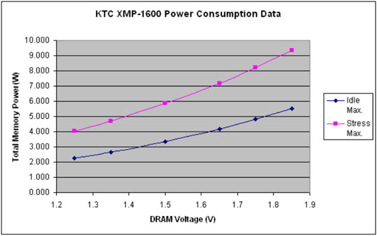

LoVo memory ran at 1600MHz from 1.25V to 1.85V. Of course, please dont try >1.65V voltages on your personal rig. Notice that Kingston used memory riser cards and is able to monitor the voltages and power consumption of just the DDR3 memory modules and not the rest of the system. This is something most review sites don’t have the ability to do.
Here is the entire Kingston HyperX LoVo DDR3 power testing system. Notice the Fluke Hydra Data Logger 2625A sitting on the right hand side! It would be nice to have one of those around here!
Notice that the Maximum Idle and Average Idle values were essentially the same when it comes to power consumption at the memory module level. It’s great to see a chart like this as you can see exactly what the modules are consuming in terms of power. Let’s focus on the Idle Max and Stress Max results.
Notice that the power consumption at idle doubles from 1.25V to 1.85V at an idle state and more than double under full load. Kingston’s testing showed that there was roughly a 3 Watt difference between running 1.25V and 1.65V at Stress Max.
