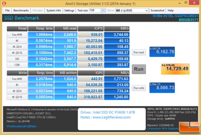

atto-p3608-anvil-apps
Benchmark Results: We also ran the benchmark with the Applications test setting of 46% compression and found nearly identical performance results with an overall score of 14,729.
