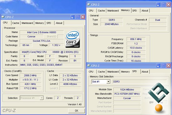

To reach 1712MHz the Intel Core 2 Duo X6800 was run at 7 x 428MHz FSB with the FSB:DRAM ratio being 1:2. The modules were pretty toasty at these settings and were reaching 42-48C on the heat spreaders without a fan on them at idle. After taking notice of how high the temperature was getting we placed the Corsair AIRFLOW over the modules.
Here is a screen shot of the test system running Sandra Xi SP2 with the memory running at 1700MHz. The memory bandwidth was found to be right at 8GB/Sec.
