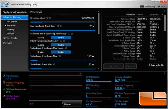

The ambient air temperature in the room was 70F or 21C. We used the new Intel Extreme Tuning Utility to monitor the overall CPU temperatures. You can independently monitor each core with this utility or the average of all of them. We enabled just the overall temperature to make things simple. As you can see from the image above the idle temperature bounced around 32-33C, which is pretty darn impressive.
Intel Core i7-3960X Processor Temperature at Load
When it comes to load temperatures we fired up Prime95 64-bit and let the system run for about 30 minutes as by then the CPU temperatures leveled off. At 100% load in Prime95 we found the Intel Core i7-3060X topping out at 57C. Not bad considering the processor is running at a very respectable 3.6GHz with all six cores at load thanks to Turbo mode.
