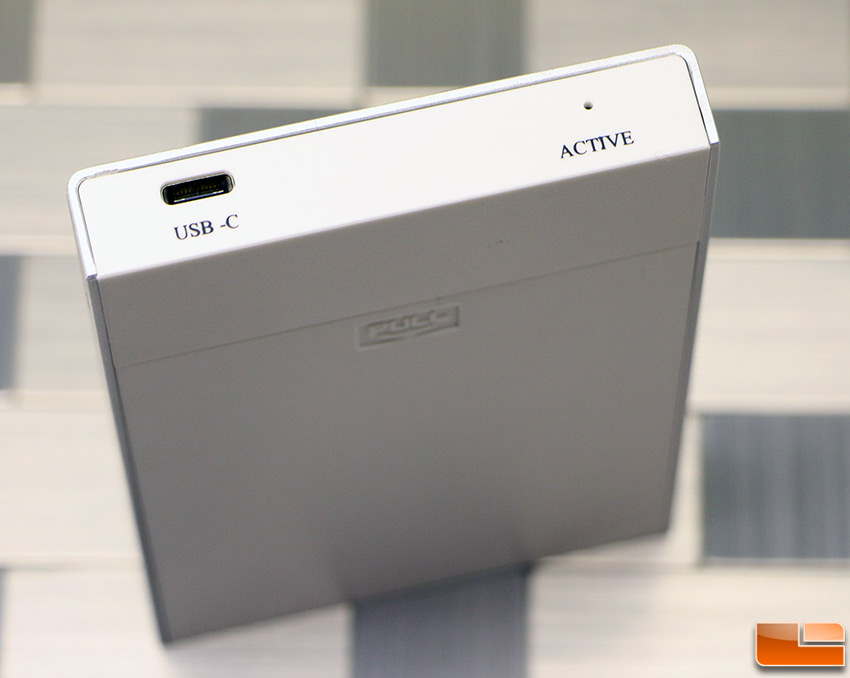

fe2008c-usb-c
Here is a shot of one end of the Inateck FE2008C that shows the USB Type-C or USB-C port as it is labeled on the enclosure and the white LED power/activity light.
fe2008c cover
Like most all Inateck products, the FE2008C is a tool-less drive, so you won’t need to fiddle around with any screws or screwdrivers to get this up and running. You just slide open the top plastic cover and then you can insert a 2.5″ storage drive. Once you have your hard drive (HDD) or Solid-State Drive (SSD) installed you just slide the cover back on and connect the docking station to your system with the included USB Type-C cable. The end of the cover has ventilation holes though, so it is possible for hot air to escape.
