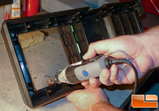

Because the drive covers pop outward, there are notches in the bezel to act as stoppers for the covers. This presents a problem for devices that occupy two bays, as I found out. They end up hitting the device when you try to re-install the bezel.
Maelstrom Case  Bezel Before Tirmmed
So, breaking out the trusty Dremel tool, I proceeded to grind these down flush so they did not interfere with assembly. I had forgotten how bad plastic smells when heated.
