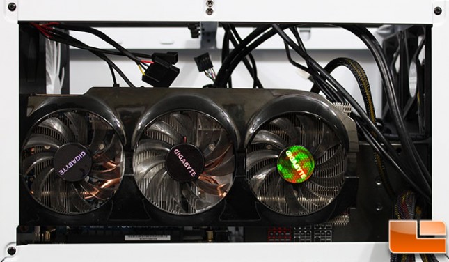

The completed install of the Node 304 goes pretty much like a standard computer install. There are differences though, mostly due to the size of the case and how hardware is installed. The Mini-ITX motherboard selected for the Node 304, takes up a large portion of the case but doesn’t have any unique installation issues. However, I would recommend installing the motherboard, then the power supply to make things a bit easier.
A Gigabyte HD 7870 is installed taking up both of the PCI expansion slots. The power supply installed in the Node 304, is modular and poses an issue with long video cards as the video card covers up the modular connections on the power supply, while the hard wired connections are fine. Also, keep in mind that using a long video card will require the hard drive cage to be removed. A video card up to 10.5″ can be installed without any issues, otherwise a smaller video card no longer than 6.7″ will be necessary.
