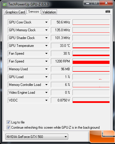

Since video card temperatures and the heat generated by next-generation cards have become an area of concern among enthusiasts and gamers, we want to take a closer look at how the EVGA GeForce GTX 560 SC Video Card did at idle and under a full load.
EVGA GeForce GTX 560 SC Video Card Idle Temperature:
EVGA GeForce GTX 560 SC Video Card Load Temperature:
As you can see from the screen shots above, the idle state of the EVGA GeForce GTX 560 SC Video Card drops the GPU core clock frequency down to 50.6MHz and the memory clock down to 135MHz to help conserve power and lower temperatures. At idle the EVGA GeForce GTX 560 SC Video Card got all the way down to 33 degrees, the lowest of any cards I have reviewed.
