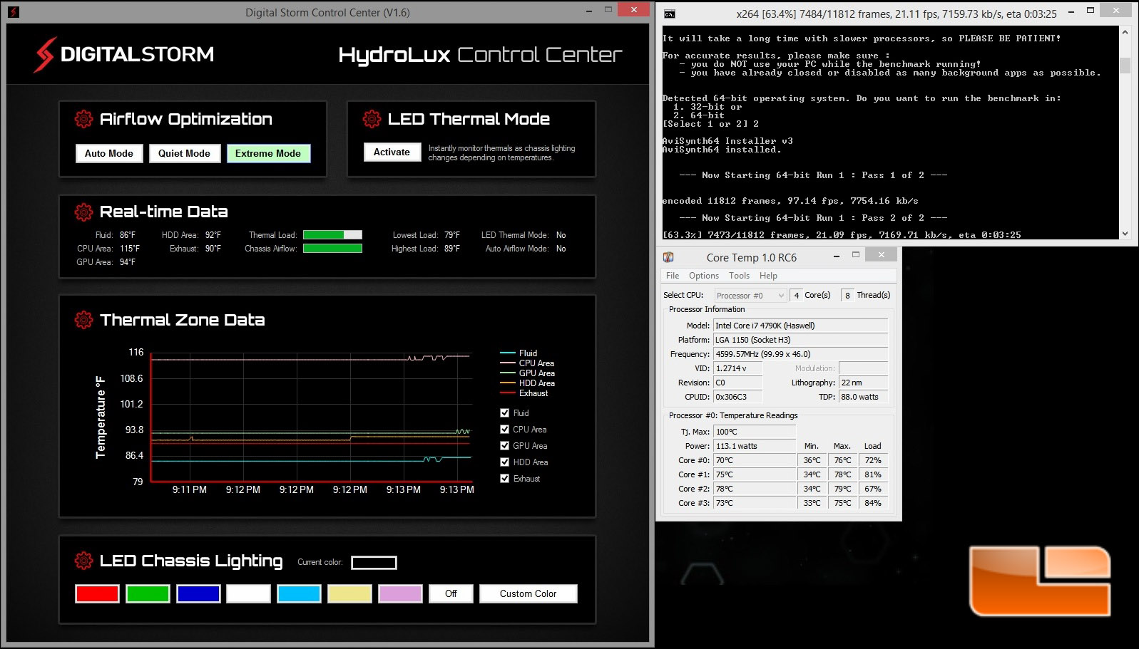

Along the lines of temperature you will find a problem regarding the probes that are on placed throughout the system and fan speed. The probes can only measure the temperature of what they’re placed next to and the results aren’t always very accurate. You will see in the below screenshot that the CPU temperature that the Digital Storm Control Center is reading is only 115*F – or approx. 46*C – and Core Temp is reading each core at 70*C or higher. (Hint: Click the image for the fully readable size)
Digital Storm Bolt 2 Temperature Probe Difference

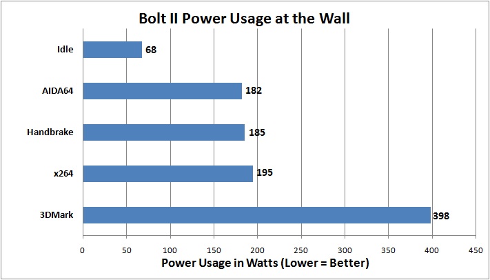

Measuring at the wall with a Kill-a-Watt meter, we measured both idle and load numbers again. 3DMark numbers will be pulled from the Firestrike test.
Digital Storm Bolt 2 Power Usage
The results for idle were pretty good, considering the discrete video card and the 4790k in this system. 3DMark load numbers showed that we’re pretty hitting pretty high numbers for our PSU, at 406 watts, but the 500w PSU still does have a good amount of headroom before it becomes a limiting factor in our system.

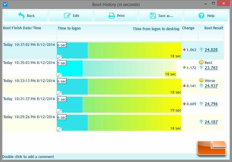

Digital Storm Bolt 2 Boot Racer History
To measure boot times, we used BootRacer 4.6 to find out how quick it brings up the OS and then how quick everything is loaded. We were happy to see the system booted up to Windows 8.1in 5-6 seconds and was fully loaded at an average of 24.5 seconds in! It’s always incredible to have a system ready to use so quickly.
