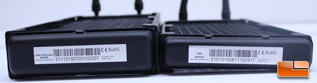

Cryorig A40 and A40 Ultimate Radiators Compared
Here, we can see the radiators of both units pictured together for size comparison purposes. The A40 Ultimate features a 38 mm thick radiator, which should certainly offer better performance than the 25 mm thick radiator of the A40, given the higher surface area. The performance capability and static pressure rating of the QF120 Performance fans will be more than adequate for moving air through the thick radiator of the A40 Ultimate and of course, the thinner A40.
Cryorig A40 Radiator Sizes Compared
We feel that the “Ultimate” designation of the unit with the thick radiator should denote more than a radiator size difference, though the pricing dynamic is not exaggerated by the models naming scheme and Cryorig doesn’t falsely advertise the A40 Ultimate as being drastically different from the entry-level A40.
Cryorig A40 Ultimate Radiator
Both radiators arrived without any noticeable damage and the fins were all straight, though there were a couple of small imperfections here and there that were likely from the factory and not a result of shipping damage. The radiators have a matte black finish that looks pretty clean.
