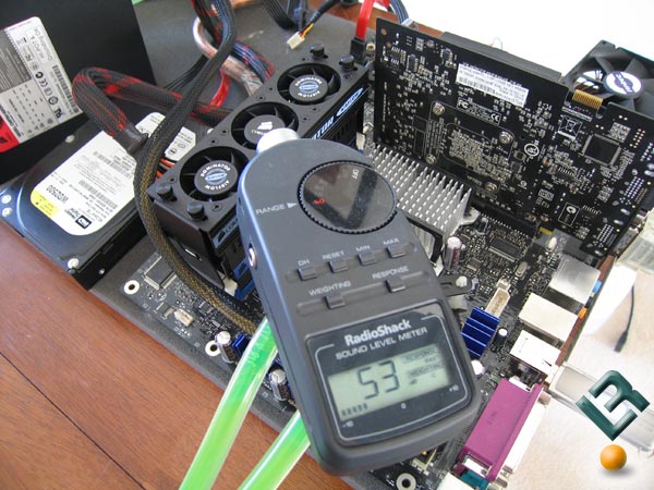

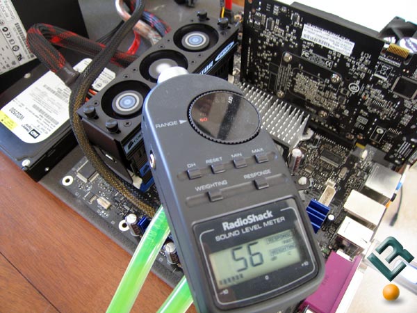

The DOMINATOR Airflow fan is designed to be matched with the DOMINATOR heat sinks and allows even more heat to be removed from the DHX XMS2 DOMINATOR modules thanks to active cooling. The fan unit contains three 40mm tachometer-controlled fans to provide impinging airflow to the memory subsystem. With the moderate RPMs required to provide adequate forced air the DOMINATOR Airflow fan is nearly silent. We tested the audio level of the DOMINATOR Airflow and found a three decibel difference with the fan running versus not. With the DOMINATOR Airflow plugged in off the modules the airflow can be felt, but it’s really not that much. A temperature difference was noted when they were installed and not installed by simply touching the heat sinks on the modules.

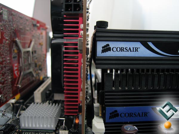

We used the DOMINATOR Airflow on a dozen motherboards and did find that it interferes with other components on certain motherboards. When using a full size video card on an Intel D975XBX motherboard the video card and metal clip on the Dominator Airflow make contact (see picture) which is never good as something could short out. It was also noted that when using a large fan like the Zalman CNPS9500 AM2 the Airflow will not seat over all four banks correctly (see picture) on the DFI NF590SLI board for AMD AM2 processors. Overall the DOMINATOR Airflow looks like a winner to us and would make for a great active cooler for nearly any system. Corsair plans on selling the Airflow on its own for roughly $20.
