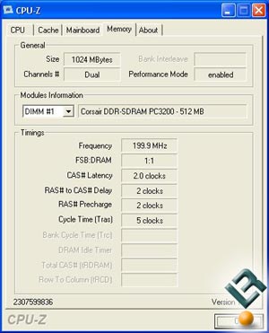

Default Settings

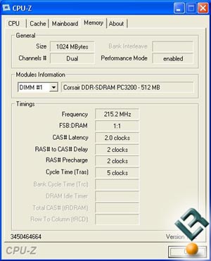

Max O/C @ 2-2-2-5

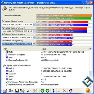

At 215MHz FSB with the memory set at a 1:1 ratio we hit the wall of the XMS 3200XL memory at the tightest timings possible. We could go past this point if we disabled the Performance Mode, but when we did we noticed a decrease in memory performance. Below is a shot of the memory bandwidth we were seeing with Corsair XMS 3200XL when overclocked to 430MHz.
Performance from Max O/C @ 2-2-2-5
We are seeing roughly 5300 MB/Sec of data transfer at 2-2-2-5: 1T timings! That is not a score to laugh at from PC-3200 memory!

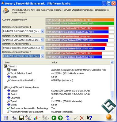

We are getting 506MHz from our PC-3200 memory at very agressive timings! If you recall this memory is orginally rated by Samsung to operate at DDR500, so we were hoping to see some numbers like this.
Performance from Max O/C @ 2.5-3-3-6
Now this is the kind performance bandwidth that we all want to see! 6100MB/Sec is some serious data transfer and we are getting it from a PC-3200 part.
