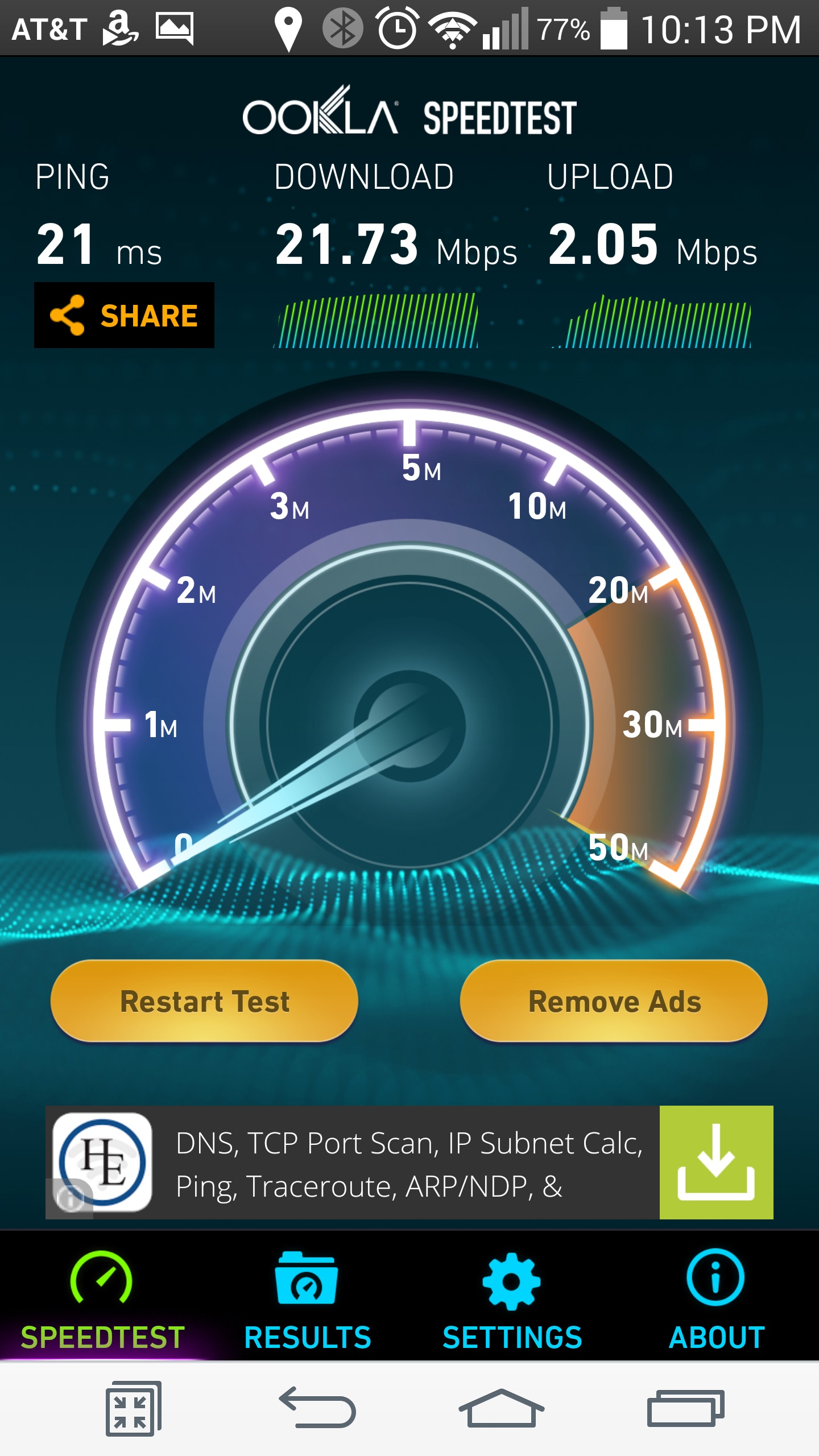

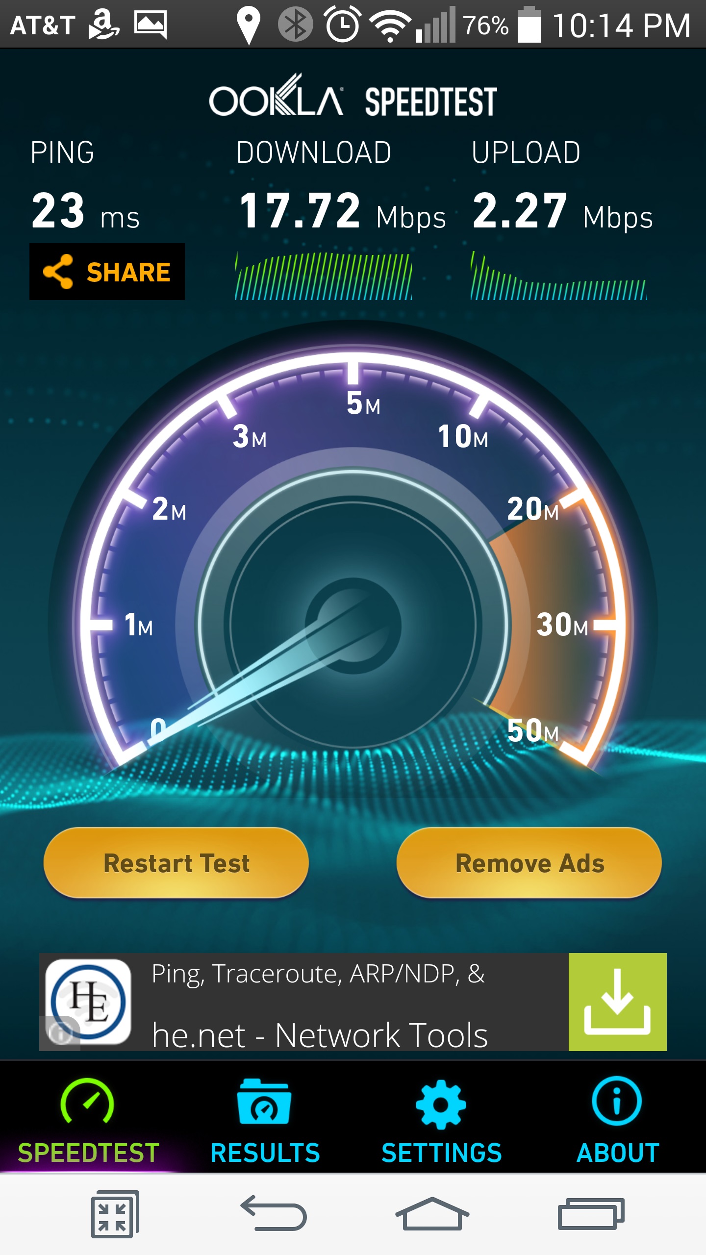

I’ve tested several devices that have passthru capabilities and found that some absolutely destroy your internet throughput, while others work just fine. I do expect some loss, but not a ton from a drive of this caliber. I set my Voyager Air 2 three feet away from my wireless router and stood another three feet away from it. I then ran a speedtest via the speedtest.net app.
Baseline Test Results: 21.73Mbps Down / 2.05Mbps Up

Voyager Air 2 Passthru Results: 17.72Mbps Down / 2.27Mbps Up

Results: As expected, I did lose a little bit of speed, roughly a 19.5% loss, but I’m happy to see it didn’t take a giant hit like some devices cause.
