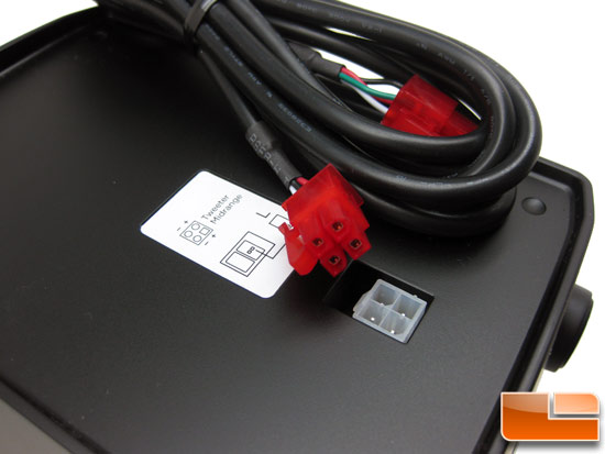

When we first saw the color coded ATX4 connectors on the speakers we didn’t think much of it, but once we set up the speaker system on our office desk we found that the wires were not long enough as we wanted to have the sub on one side of the desk and the speakers on each side of an AMD Eyefinity triple monitor setup. We asked Corsair if they had some longer cables for us to use, but they don’t right now. Corsair plans on making longer cables and offering them on their website, but for now there is nothing you can do unless you want to splice into these ATX4 connectors and make them longer. These cable connectors are what you normally would see on a power supply! We asked Corsair why they would use such a cable and Dylan Rhodes, Director of Marketing for Audio, had this to say:
“The ATX connectors are due to the amount of power sent to the satellites; they’re driven by amplifiers generating 56 watts for each satellite (40 to the midrange, 16 to the tweeter). The usual suspects — RCA, 3.5mm, etc. — aren’t rated to safely handle that much power. We did consider using standard speaker wire, but since the satellites are bi-amplified, they would have required two paired cables per satellite. The extra installation time and the look of all that silvery speaker wire made us rule it out. ATX 12V connectors provided an elegant solution — it’s a four-wire cable with one-click connection.
We’re preparing extended length kits for those customers for whom six feet from sat to sub isn’t enough. I’m sorry we didn’t have them ready at launch, but they’ll be available soon.”
