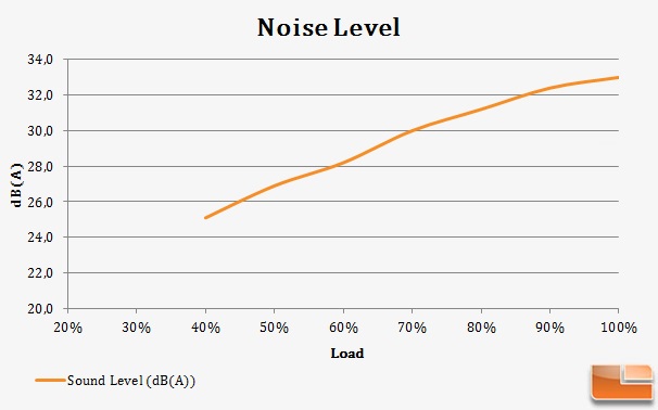

rm650noise
We recorded no noise level readings up to 40% load because the fan was entirely stopped up to that point. When we switched to 40% load, the fan started after a few seconds, yet it may only be heard if someone places an ear very close to it. As the load increased further, so did the speed of the fan, which however became clearly audible only when the load exceeded 80% of the units capacity.
