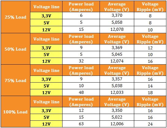

Testing results (Regulation & Ripple)

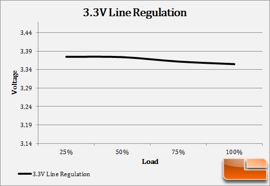

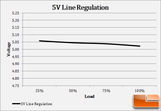

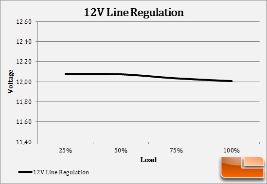

Despite the lower price and different OEM, the electrical performance of the AX860 remains astounding. This is the first power supply we have ever tested capable of regulating all of its voltage lines within 0.6% across the entire load range, shattering the vast percentage of its opposition on that particular front. The voltage ripple filtering is also exceptional, with the maximum ripple we recorded being 24mV on the 12V line at maximum load, a mere sixth of the 120mV design limit.
