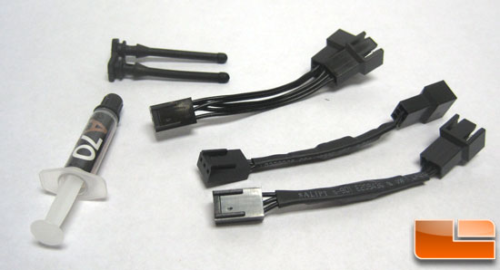

The A70 also comes with a Y adaptor for powering both fans from one fan header, two inline resistors to throttle the fan speed from 2000 RPM to 1600 RPM, and a tube of thermal paste.
