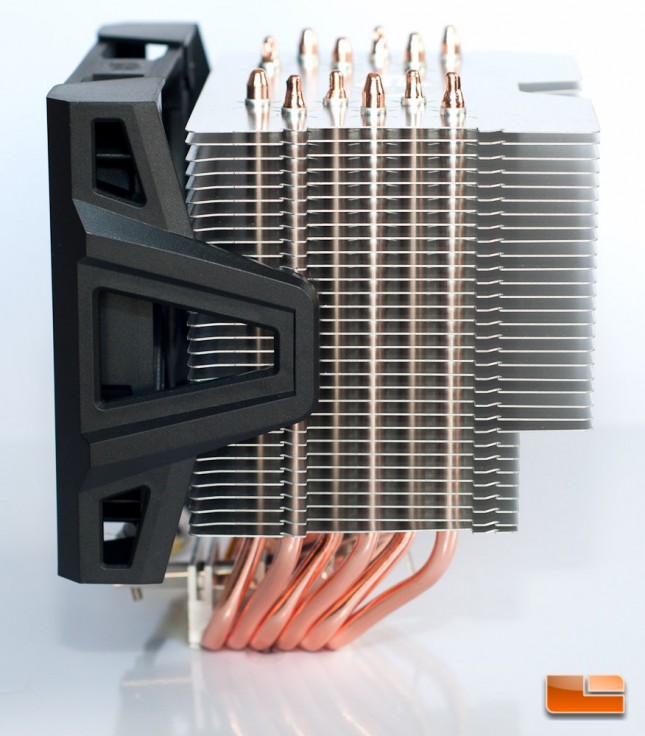

Finally getting the Hyper 612 V2 out of the box, you will begin to notice all of the aforementioned updates that Cooler Master has made in redesigning this cooler. Let’s take a quick tour around this cooler and see what makes it so great.

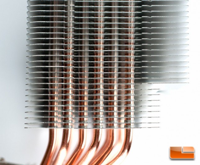

This cooler is made up of three components to remove heat from your CPU, including the heat pipes, cooling fins, and the fan. Let’s start off with the heat pipes.
The heat pipes will make direct contact with your CPU, applying Cooler Master’s CDC (Continuous Direct Contact) technology. You will find no gaps between the heat pipes like you will on some other coolers, allowing the heat to be exchanged more effectively.

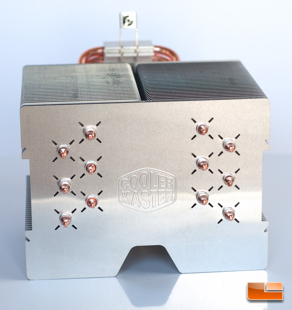

The heat pipes then in turn rise up through the top stack of the cooler and dissipate any collected heat here. You don’t necessarily need to use a fan to dissipate the heat via conventional passive cooling, but you obviously won’t get the full performance out of this cooler.
Speaking of fins, there are 31 aluminum fins in total, which Cooler Master redesigned from the original Hyper 612. These fins is now a folding fin design to provide higher efficiency of heat dissipation. The entire stack with the heat pipes and base will bring this cooler to a very tall 160.4mm, or approximately 6.3 inches.
To assist in removing heat from the system, you will use the single included 120mm fan that’s capable of pushing 44.2 CFM with 1.6 mmH2O at 20 dBA or less. This fan simply clips onto the body thanks to the included metal brackets, making for a very effortless install, or if you want a sleeker install, you can use the black plastic bracket that screws onto the fan. Should you want to utilize a push-pull scenario with this cooler, you will end up using both components.

While this cooler is oddly shaped, remember that CM kept you in mind when designing this cooler. On the back side there is a 28mm cutout to provide clearance for your motherboard’s VRM heat sinks or RAM modules with tall heat spreaders.
