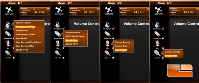

Upon starting Xonar U7 Audio Center, a popup cues instructions on how to modify the inputs and outputs as well as their settings. Clicking the checkboxes on the icons on the left will activate that input or output and submenus are accessed by right-clicking the icon on the left.xonarU7_01_software
The menu layout puts a setting summary at the top, volume control at the top left, submenu access to the left, and the active submenu in the center. The displayed submenu is headphone L/R volume.xonarU7_02_software
These are all the submenus for all the inputs and outputs. They are accessed by right clicking an icon.xonarU7_03_software
