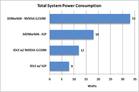

Power Consumption
Power Consumption Graph
At idle, the ASUS UL80VT with Intel’s CULV Processor only consumed 8 watts while using the integrated graphics, and when we turned on the NVIDIA GeForce G210M video card, it only added 4 watts to that number, bringing the grand total to 12 watts at idle. To test the notebook under load, we took readings from our Seasonic Power Meter while running 3DMark06, again both with integrated graphics and with discrete graphics running. With the integrated graphics, the notebook was only consuming 18 watts. Once we turned on the video card, it almost doubled to 33 watts. Still, compare that to an energy saver light bulb that uses 26 watts of power to emit the same amount of light as a 100 watt bulb. If you are using the integrated graphics, you are using less power than the light bulb you’re using to see by! Even if you turn on the integrated graphics for gaming or watching movies, you still can’t complain about the energy usage from this notebook. I have to give props to ASUS for coming out with such an energy-efficient machine that you can use without hitting multiple keys at once or squinting at a tiny screen.
