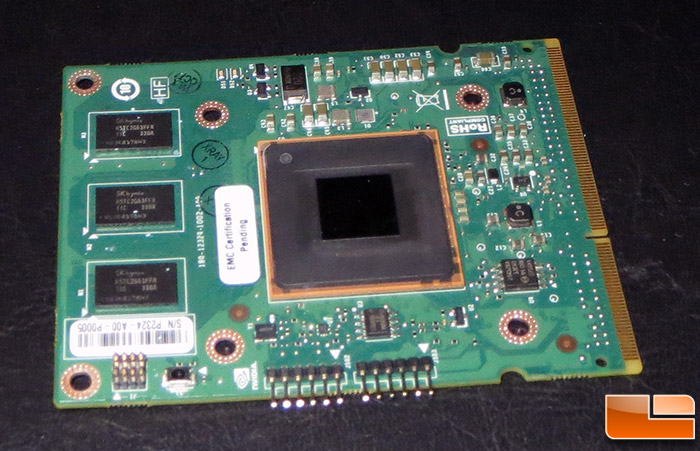

NVIDIA G-SYNC Module
NVIDIA has some pretty smart engineers working for them and they were able to come up with a way to allow the GPU to control the rate at which the game frames are delivered and the refresh rate of your monitor.This requires special hardware inside the monitor. The hardware hidden inside the display is the NVIDIA G-SYNC module and it allows monitor to synchronize the output of the GPU, instead of the GPU to the monitor, resulting in a tear-free, faster, smoother experience that has redefined the gaming experience that we have become so used to. It also doesn’t hurt that most G-SYNC monitors are 120Hz or 144Hz and most people will be upgrading from an older 60Hz display. This means that most gamers will be able to eliminate screen tearing and greatly reduce stutter and input lag while gaming at a higher refresh rate in general.
gsyncThe diagram above shows how NVIDIA G-Sync works. The gaming PC with the NVIDIA GeForce GPU inside sends a signal to the G-SYNC controller built into the monitor and tells the monitor when to update the display. This allows the GPU to render the frame at whatever speed it requires, because the monitor will wait until the full frame is delivered. This means no tearing as you have a cariable refresh rate that is adjusted in real-time. it works regardless of the game title you are playing and the only real caveat is that it only works over DisplayPort. The G-Sync module itself doesn’t support HDMI or DVI video connections as it needs a solution that can handle data packets and DisplayPort was the answer. You will also need an NVIDIA GeForce GTX Ti Boost or ‘higher’ video card for G-Sync to work. It obviously will not work on AMD graphics cards.
