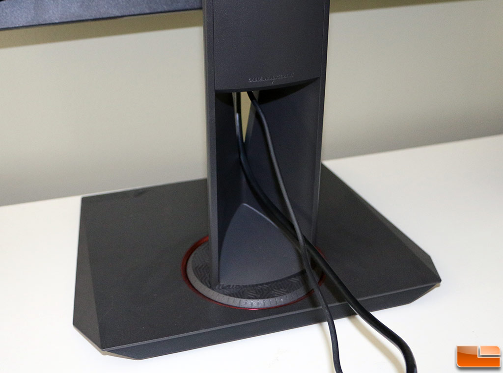

There is also a smart cable management built into the stand that allows for the power and DisplayPort cable to be routed to the display. We have seen some people having DisplayPort issues and we highly suggest using the cable that comes with the monitor. If you are using an old one and run into issues you might want to swap out the cable as not all DisplayPort cables are the same. A DP cable has 20 pins, but one of the pins should not be connected should not be connected per VESA standards. (Pin 20 is the one that should not be wired and it is the “DP_PWR Power for connector”) Some lower-end cables have all 20 pins wired which feeds back 3.3v 500mA of power and that is causing issues for some people using G-Sync displays.
The ROG SWIFT PG278Q monitor stand base has a pretty cool looking pattern in the plastic with a red ring around where it attaches into the base. This red ring is lit with red LEDs that are on by default and it looks pretty cool at night in in a darkened room when gaming. If lights aren’t your thing you can turn off this feature by going into the OSD and under the system setup menu you can disable the “light in motion” option.
