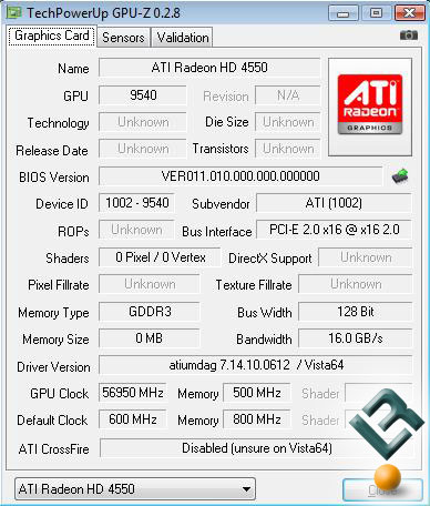

I fired up GPU-Z 0.2.8 to get the specifics of the new graphics card, but as you can tell GPU-Z can’t read the card correctly right now. The process technology for the Radeon HD 4550 is 55nm with a die size of 73mm2 that contains 242 million transistors.
