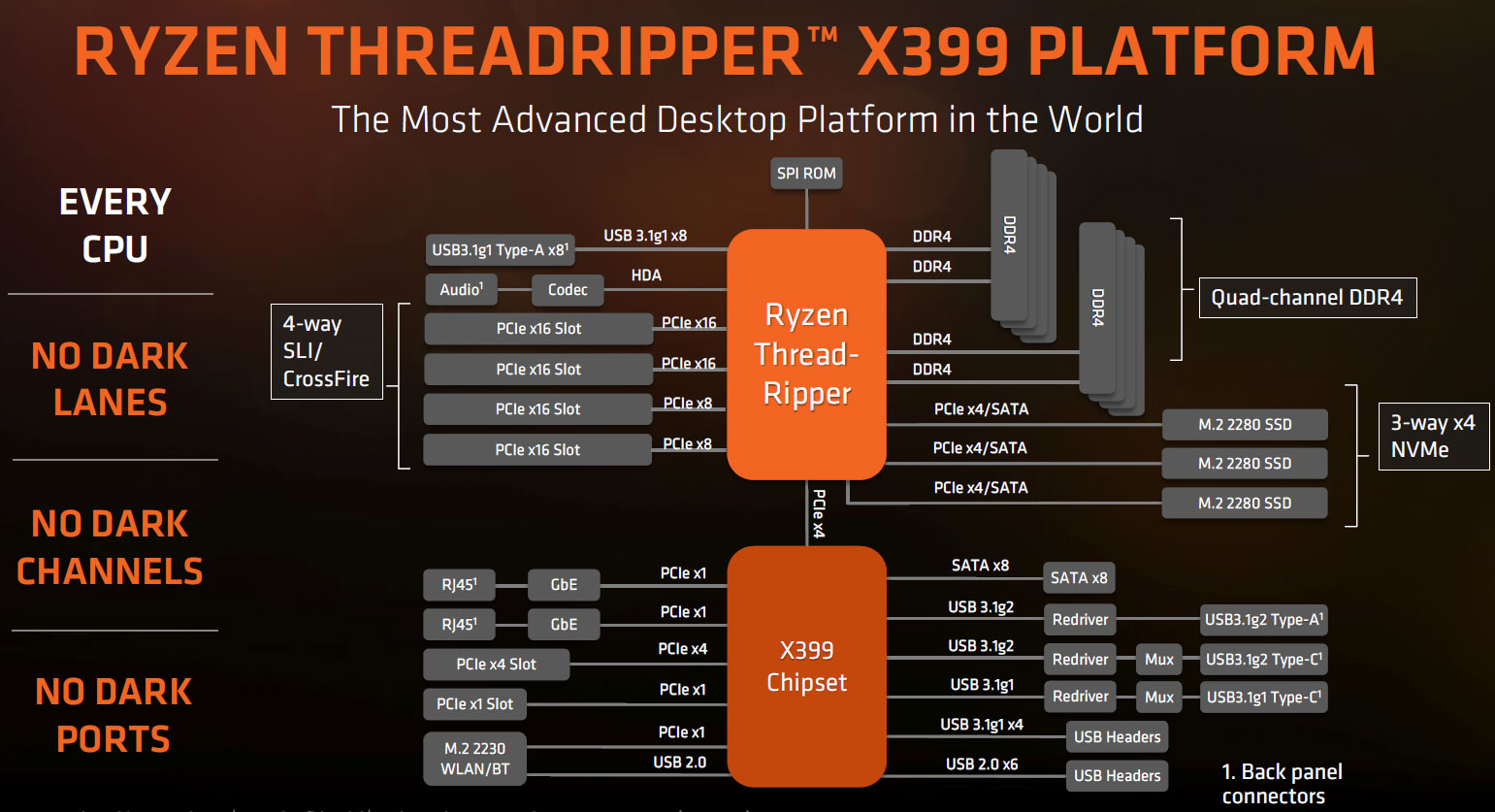

AMD X399 Platform
The AMD Ryzen Threadripper X399 platform goes along with the Threadripper processors and is a beastly platform. These new chips have 4,094 contact pads on the bottom and fit into the AMD TR4 socket (also known as Socket SPR3r2). You have quad-channel DDR4 3200MHz memory support right off the bat with 64 PCIe lanes available on all Threadripper processors. You can do 4-way SLI/Crossfire setup and run a 3-way PCIe x4 NVMe RAID array for mass storage with ease on one of these boards!

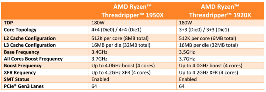

One way to think of the AMD Ryzen Threadripper 1950X is that is is basically at the highest level essentially two Ryzen 7 1800X processors at a 200MHz lower clock speed. Both of AMD’s current Ryzen Threadripper chips feature 512K per-core of L2 cache, but there is 8MB total on the 1950X and 6MB total on the 1920X due to the core topology. The AMD 1950X has a 4+4 core configuration whereas the 1920X has a 3+3 configuration.
AMD Threadripper Specifications
The table above better shows the differences between the 1950X and the 1920X. You can also check out a CPU-Z screen shot of the 1950X below.
