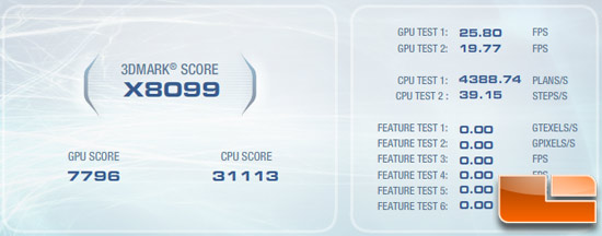

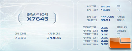

AMD Radeon HD 6870 Video Card Overclocking
The AMD Radeon HD 6870 comes with a 900MHz core clock and 1050MHz memory clock. We ran auto-tune on this card and the program came back saying that it was able to reach 940MHz on the core clock and 1140MHz on the memory. This is a 40MHz overclock on the core and a 90MHz boost on the GDDR5 memory ICs.

The AMD Radeon HD 6850 Video Card Stock 900MHz/1050MHz:

The AMD Radeon HD 6850 Video Card Overclocked 940MHz/1140MHz:
ATI Radeon HD 6870 OC Video Card Overclocking
Running 3DMark Vantage with the Extreme preset we got a
score of X7645. The score went up X8099 3DMarks when overclocked, which
was an improvement of 6% with this easy to do overclocking method. Seeing a nice 6-9% performance gain with pretty much zero effort was nice to see and when we have more time we are sure these cards could be pushed even harder!
