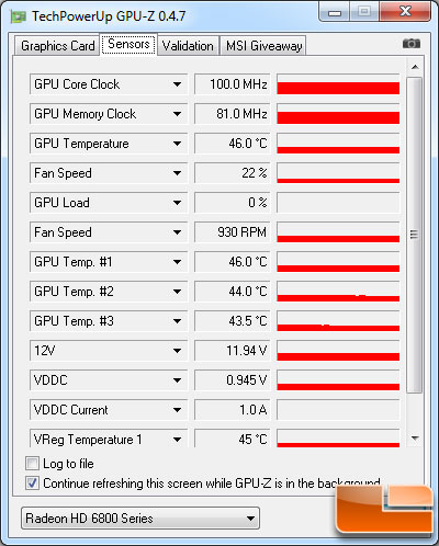

AMD Radeon HD 6850 1GB Video Card Idle Temperature:
AMD Radeon HD 6850 1GB Video Card GPU-Z Details

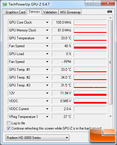

XFX Radeon HD 6850 1GB Video Card Idle Temperature:

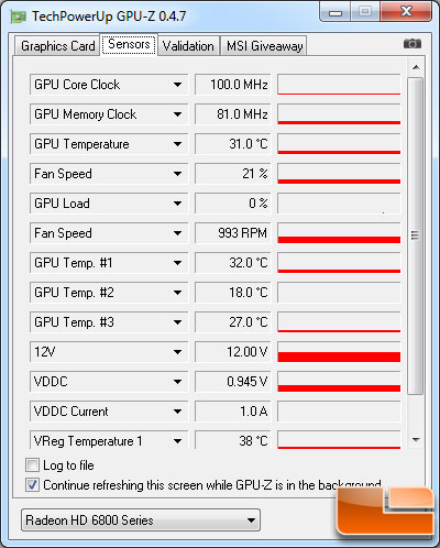

AMD Radeon HD 6870 1GB Video Card Idle Temperature:
AMD Radeon HD 6870 1GB Video Card GPU-Z Details
As you can see from the screen shot above, the idle state of the Radeon HD 6800 series drops the GPU core clock frequency down to 100MHz and the memory clock down to 81MHz to help conserve power and lower temperatures. At idle on an open test bench the Radeon HD 6850 video card temperature was observed at 46C and the Radeon HD 6870 was at 31C. The fan speed on the card was around 21-22% and nearly silent as it spins under 1,000 RPM at an idle.

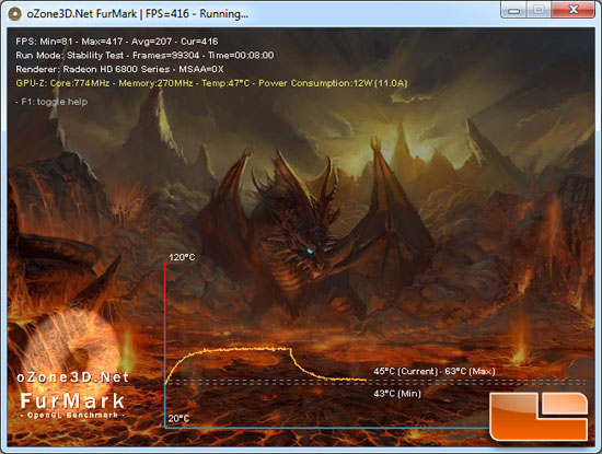

XFX Radeon HD 6850 Video Card Load Temperature:
AMD Radeon HD 6850 Video Card Load Temp

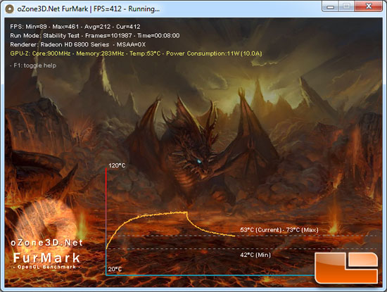

AMD Radeon HD 6870 Video Card Load Temperature:
The GPU fan got up to 49% or 1920RPM during temperature testing and it was definitely audible over the CPU coolers fan. The AMD Radeon HD 6870 peaked at 73C and the Radeon HD 6850 peaked at 81C.

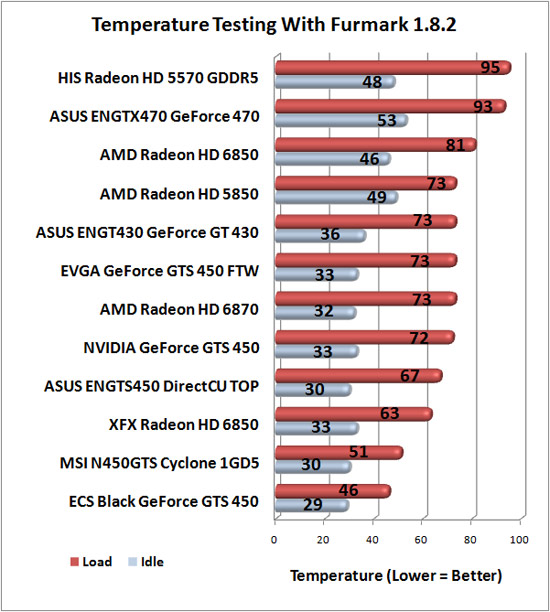

Temp Testing
Most of the mainstream video card temperatures are right around 73C, but there is one card to take a closer look at. The AMD Radeon HD 6850 reference design cooler isn’t that impressive and had a peak load temperature of 81C. The custom cooler on the XFX Radeon HD 6850 only got to 63C at load! It also had a much lower idle temperature, so you can see that putting a decent air cooler on the Radeon HD 6800 series will really help bring down temperatures. Having full load temperatures in the low 60’s on these are insane! Take a look at the GeForce GTX 470 that NVIDIA says is price competitive with the Radeon HD 6870. It tops out at 93C versus just 73C on the Radeon HD 6870!
