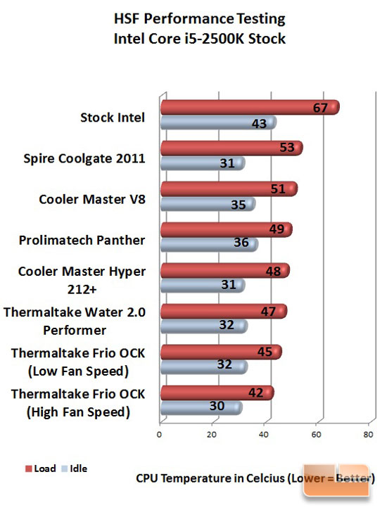

Thermaltake Water 2.0 Performer Stock Chart
With our test system at stock settings you can see that the
Water 2.0 Performer out performed every air cooler Ive tested so far with the
exception of the Thermaltake Frio OCK. I was quite surprised that an air cooler
was able to outperform the Water 2.0 Performer. So surprised that I remounted
and ran my tests two more times just to make sure it wasnt an error on my
part. Thats not to say that the Water 2.0 Performer didnt perform very well,
coming in at just 47 degrees Celsius under full load is very respectable. The
thing that blew my mind was the virtual silence coming from the Water 2.0
Performer. I wasnt able to hear the fans or the pump over the rest of my system!
