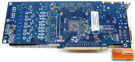

Sapphire Radeon HD 5850 1GB Toxic Video Card Back
Flipping the Sapphire HD 5850 TOXIC Edition video card over you can get a better look at the back, and if you look closely you’ll see that the entire GPU cooling solution is held on by the four silver Philips screws around the GPU. The two black Philips screws on the left side are used to hold on the passive cooler for the voltage regulators. In case you are wondering, Sapphire did use their Black Diamond chokes on this card again, which is said to help lower operating temperatures and increase the efficiency of the chokes in general by up to 25%.
