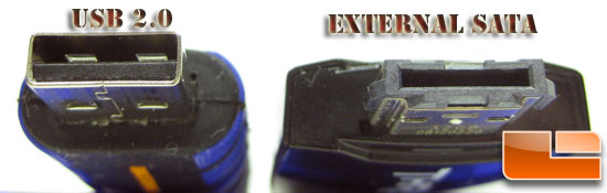

OCZ Throttle eSATA Flash Drive - 32GB
To get a better idea of what the USB 2.0 and eSATA connectors look like I took a picture of each sitting next to each other. You won’t be able to mix the two connectors up as the you can’t force one into the other. Not all systems will have an eSATA port, so if you are wanting an eSATA drive be sure your system supports it!
