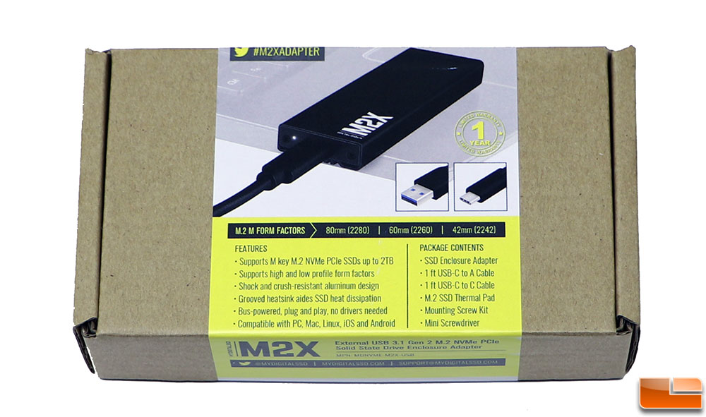

MyDigitalSSD M2X Retail Box
MyDigitalSSD is always trying to keep costs down and ships the M2X in plain cardboard packaging with a nice full color label that also seals the box. The label is jam packed with useful information as well as an image of enclosure along with images of the two included USB connectors. You can find out pretty much everything you need to know about the M2X from the label. It supports M.2 drives with the ‘M’ key format in capacities up to 2TB and lengths of 42mm (2242), 60mm (2260) and 80mm (2280). The drive is bus-powered and should work on PC, Mac, Apple iOS and Android devices. The part number is MDNVME-M2X-USB and it is backed by a 1-year limited warranty.

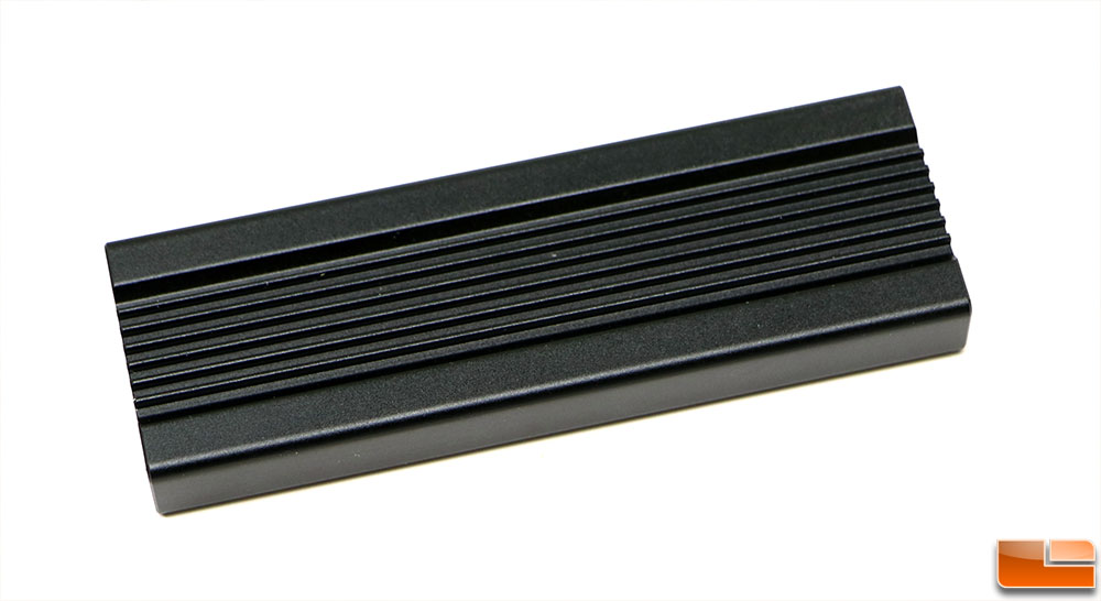

The M2X enclosure is about as simple as it gets. It’s entirely made from aluminum with a black anodized finish for a nice durable look and feel. The dimensions of the M2X are 99mm x 42mm x 13mm and it weighs just 1.7 ounces (48g) without a drive. Both ends are capped off with metal plates that are held to the main body with two screws. One end has the USB Type-C connector and a tiny hole for a white LED that shows if the drive has power. This enclosure is not sealed tight, so it is not designed for use in areas where dirt or water could get inside the housing.
MyDigital SSD M2X heatsink fins
One side of the M2X has a row of tiny cooling fins that help dissipate heat from M.2 PCIe NVMe drives that will be used inside. MyDigitalSSD includes one thermal pad that will easily cover a M.2 2280 form factor drive.

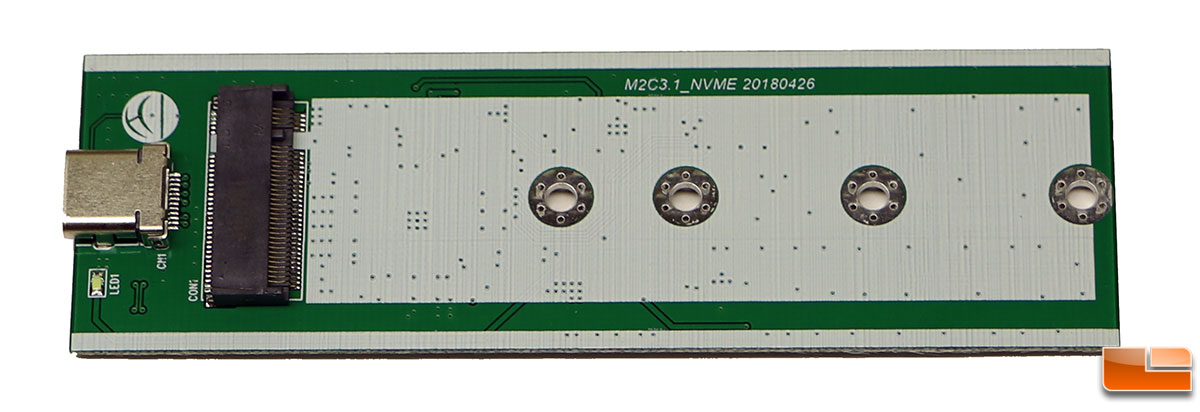

Once you remove the end cap from the M2X and slide out the circuit board you’ll find just how straight forward this product is. On one side you have the M.2 ‘M’ key slot, so there is only one way to install a Solid-State Drive. So, most M.2 PCIe drives are supported. We also need to confirm that both single-sided and double-sided drives with in this enclosure!

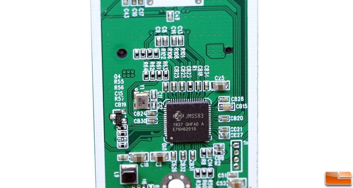

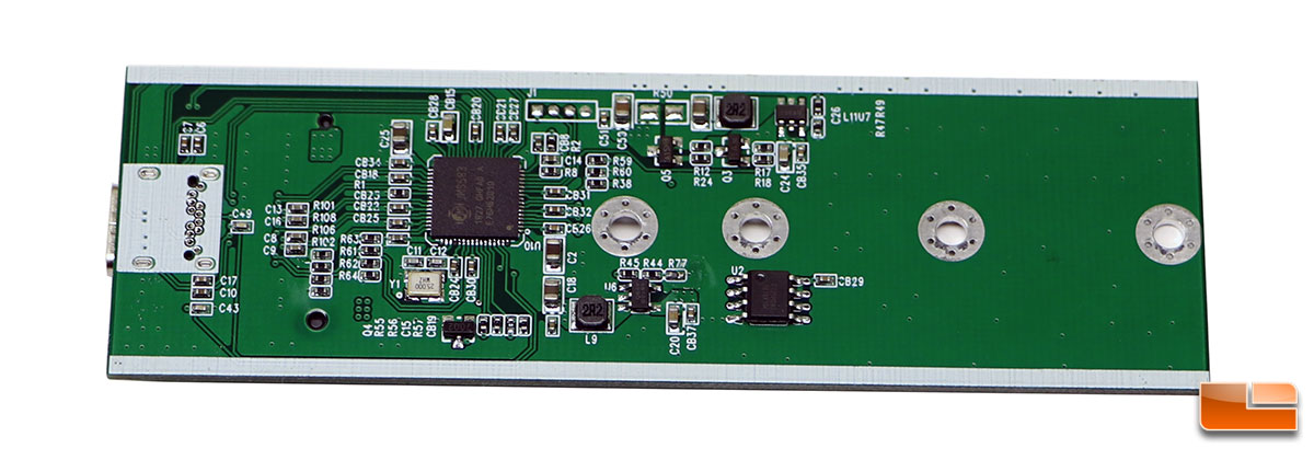

Flipping the drive over you’ll discover the JMicron JMS583 USB 3.1 Gen 2 to PCIe Gen3x2 Bridge controller. This bridge chip was just introduced at Computex in June 2018 by JMicron, so MyDigitalSSD is one of the first companies to launch a product using it. This controller is capable of hitting 1000 MB/s read and write speeds, supports TRIM, UASP and is entirely USB bus powered. It also doesn’t require any drivers to be installed. Finally, NVMe over USB has arrived!!!

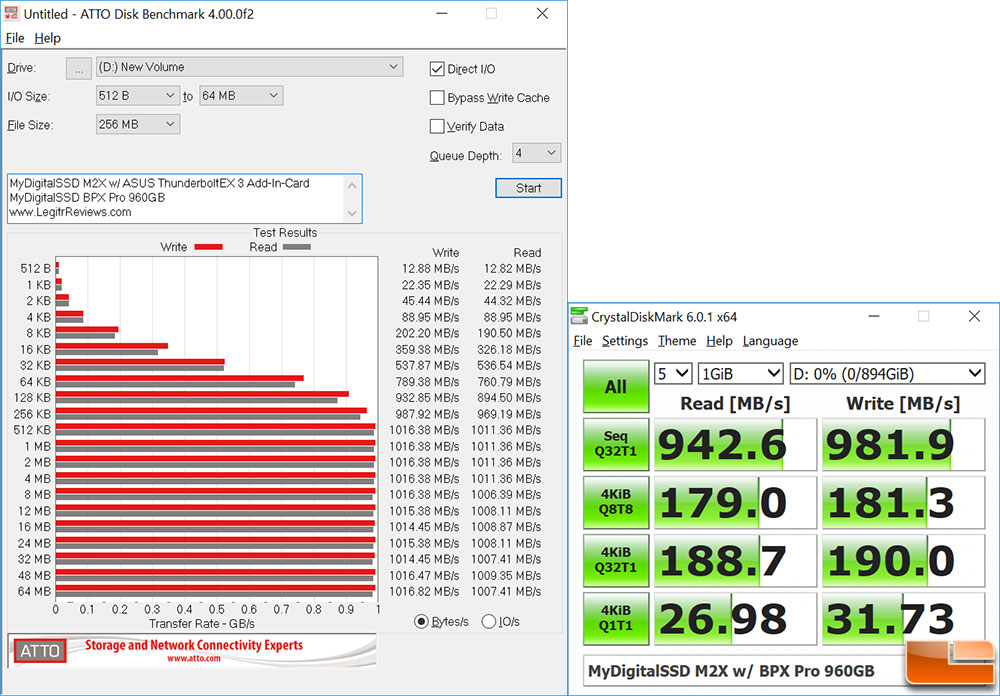

All testing was done on our ASUS X299 Deluxe Motherboard running an Intel Core i9-7980XE Extreme Edition Processor and Windows 10 Pro 64-bit v1803. The MyDigitalSSD M2X was plugged into the ASUS ThunderboltEX 3 Add-In-Card for testing.
MyDigitalSSD M2X w/ MyDigitalSSD BPX Pro 960GB SSD
MyDigitalSSD M2X w/ MyDigitalSSD BPX Pro SSD

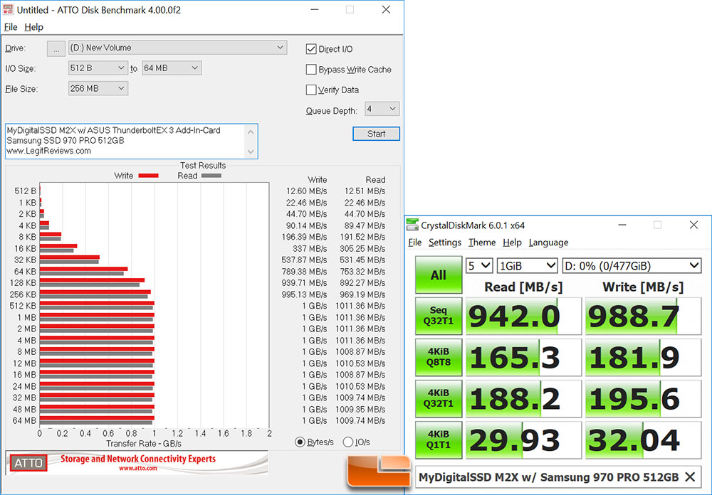

MyDigitalSSD M2X w/ Samsung SSD 970 Pro 512GB SSD
MyDigitalSSD M2X w/ Samsung SSD 970 PRO 512GB SSD

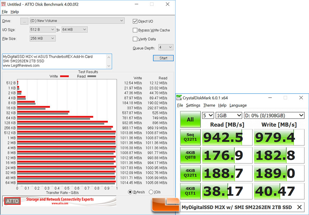

MyDigitalSSD M2X w/ SMI SM2262EN 2TB Reference SSD

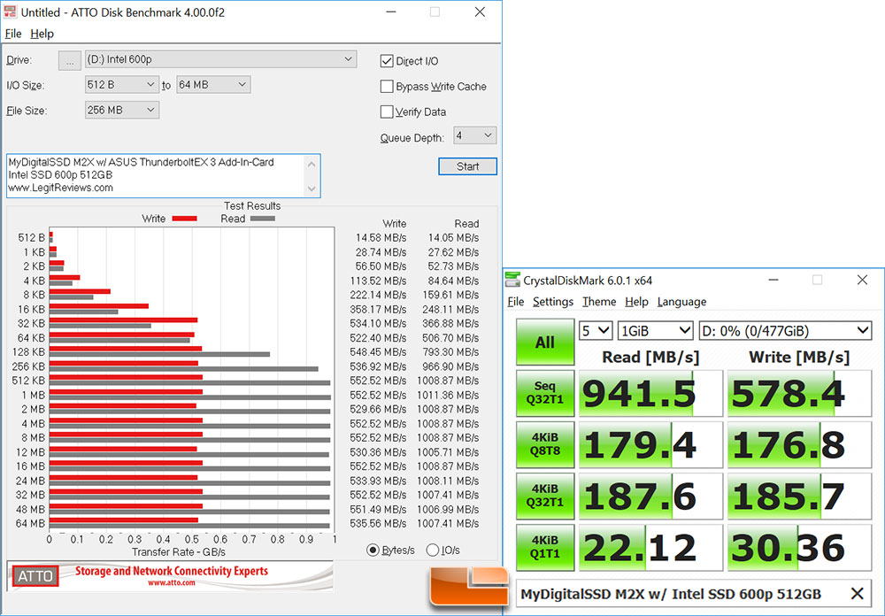

MyDigitalSSD M2X w/ Intel SSD 600p 512GB
MyDigitalSSD M2X w/ Intel SSD 600p 512GB Drive

We were able to hit over 1000 MB/s for sequential read/write speeds in ATTO Disk Benchmark on three of the drives with no data on them with ease. The WD Black PCIe NVMe drive from 2017 is rated at 2050 MB/s read and 800 MB/s write and we managed to hit 868 MB/s read and 780 MB/s write. This drive was pulled from a working system to be tested, so it had 70GB of data on it as well as the four Windows 10 UEFI partitions. These are very impressive performance numbers and we were easily able to stream 4K and 8K video from this portable enclosure.

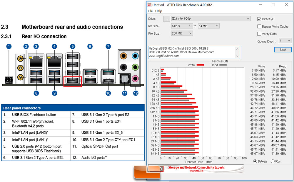

usb2 testing
What happens when you plug the MyDigitalSSD M2X into an older USB 2.0 port with an NVMe drive? Will it have enough power or even work? We gave that a shot with the Intel SSD 600p 512GB drive in the M2X and it worked perfectly on our ASUS X299 Deluxe Motherboard when plugged into the USB 2.0 port highlighted in the diagram above in red. The performance of this combination on a USB 2.0 port managed to reached 45.88 MB/s read and 41.56 MB/s write, which is wicked fast for USB 2.0. The aging USB 2.0 port can theoretically transfer data at 480 mbps or 60 MBps.
