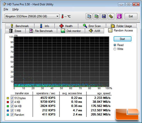

Random Access Read Test Results:
HD Tune Random Access Benchmark
Benchmark Results: When it comes to the random access read performance test the Kingston SSDNow V+ Series 256GB SSD does great with the Samsung controller and 128MB of cache.
