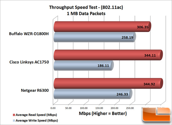

Next, we turned off the built-in Wi-Fi on our laptop and then paired a Netgear R6300 802.11ac Router configured as a bridge to each of the wireless AC routers in our test suite. We are now ready to see what a true 802.11ac wireless network can do. Again, we used LAN Speed Test to check the throughput of our 1MB and 100MB data packets.
Wireless Speed Test
Test Results: Results like this are really why we absolutely love the 802.11ac wireless standard. We see an almost 287% increase in Average Write speed with the Linksys EA6500. Netgear again leads the way, but just barely due to incredible Average Write speeds.
Wireless Speed Test
Test Results: Again we see results that are pretty outstanding when compared to standard wireless-n speeds. The Linksys EA6500 shows an almost 300% increase in Average Read speeds and goes to the top of our AC router speed test. Its not apparent why Write speeds are relatively slow when compared with the Netgear R6300.
