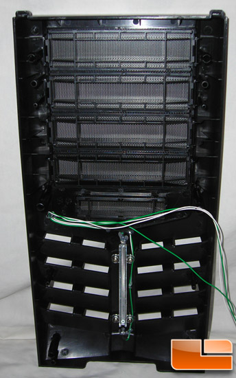

Behind the front panel are 2 LEDs inside a tube to amplify and spread the light from the LEDs to give the front of the case that ambient glow. These are powered by the 5v rail of the PSU via a 4pin molex pass through connector.

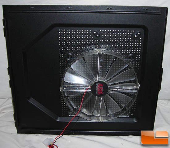

Finally, here’s the side panel of the case, with its 230mm fan. While this is one of the most densely populated fans I’ve looked at in this size category, its overall shape makes it look like it could be loud. The blade design, plus the number of blades, could be both a pro and a con for it depending on the max RPM of the fan. Too high and it could be very loud; too low, and it won’t push any air. We’ll be testing this fan and the 120mms in the coming pages.
