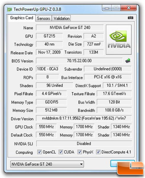

GPUz 0.3.8
The AXLE GeForce GT 240 initially isn’t a card to write home about, as it is identical to the NVIDIA reference design as stated before, so let’s fire up MSI’s Afterburner GPU tweaking utility.
