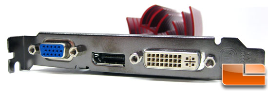

The ATI Radeon HD 5450 graphics card has a single dual-link DVI-I output
along with DisplayPort and VGA outputs. We were told by ATI that the
add-in board partners can change this configuration around and that many will have an HDMI port instead of the DisplayPort. If you want to run ATI Eyefinity you must get a card like this as DisplayPort is required for Eyefinity.
