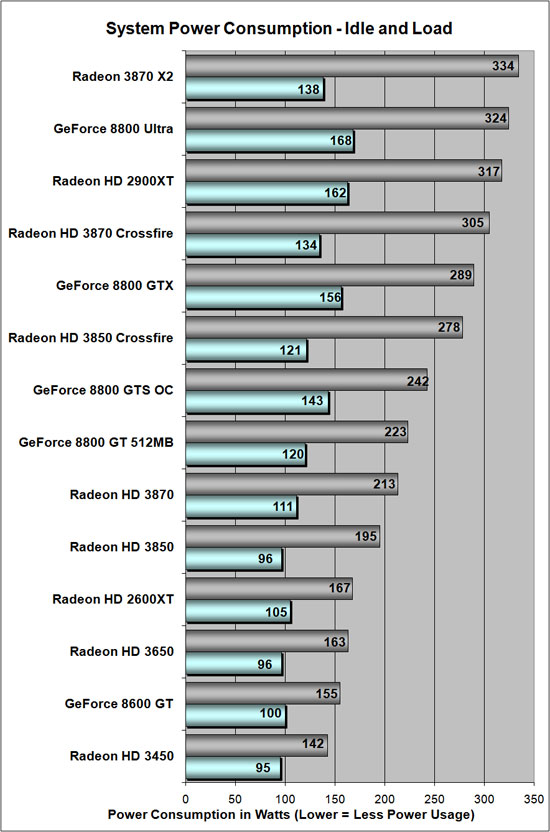

For testing power consumption, we took our test system and plugged it into a Seasonic Power Angel. For idle numbers, we allowed the system to idle on the desktop for 15 minutes and took the reading. For load numbers, we measured the peak wattage used by the system while running the game World in Conflict at 1600×1200 with medium graphics quality.
Power Consumption Results
Power Consumption Results: When it comes to power consumption the ATI Radeon HD 3870 X2 didn’t shock us when it consumed more power than any single graphics card combination that we have looked at recently. At full load the entire system consumed 334W , which was just higher than what the GeForce 8800 Ultra consumes. For a card that has a full TeraFLOP of processing power would you expect any less? The idle power consumption was very impressive compared to NVIDIA based graphics cards though, so keep that in mind as most computers sit at idle anyway.
