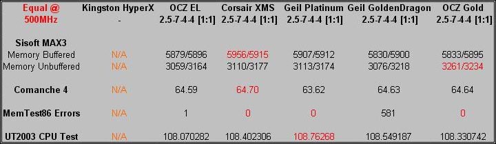

Once we completed the testing at their advertised speeds we wanted to see the results at equal timings. For this we set all the modules at 2.5-7-4-4 for testing them at the same timings.
Kingston HyperX fails to post at CL2.5 even with the vDimm raised to 3.2V. This was due to the Samsung IC’s used on the module. At equal timings you can see the three modules without errors were also the modules that had no errors at default testing.
